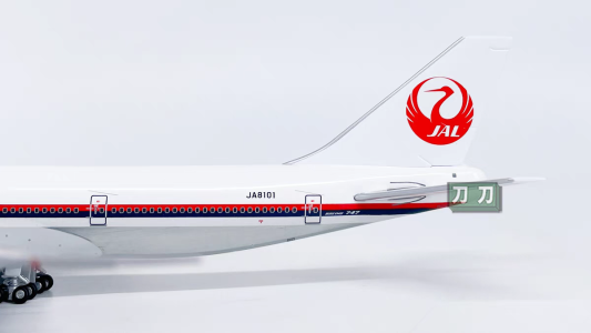

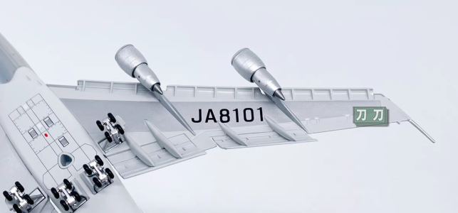

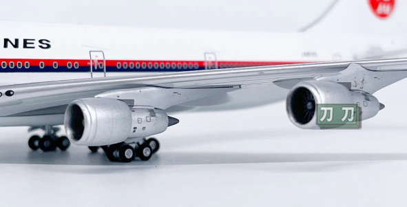

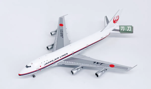

Model teaser from HX model, partially physical.
Flaps down Version
1:400?! 😍

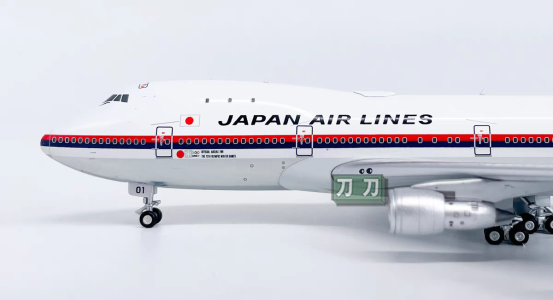

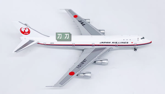

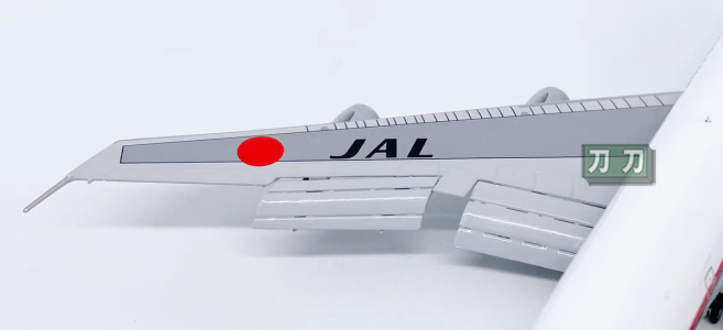

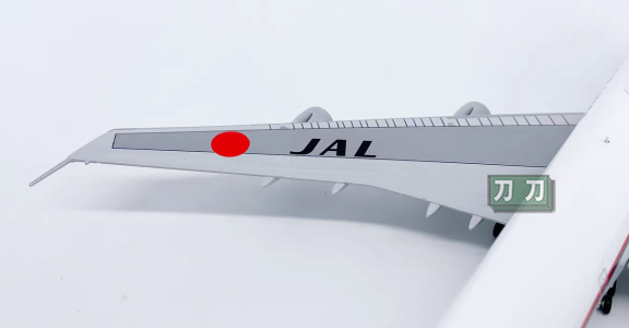

Not bad, but also not accurate and not something I’d expect a manufacturer to do in 2025. They got it right on the 747-400, so they have the know-how. It is just surprising to me that they did it this way on both the 1:400 scale version and SQ 1:200 versions
I'd have been surprised if not as SQ/HX/.... obviousely go through the same hands, consequently sharing the same master/CAD.
The wing joint however isn't the biggest problem for my eyes. There are so many things that are off on these HX like the upper deck, but particularly the aft fuselage and v.tail keep me from buying any.

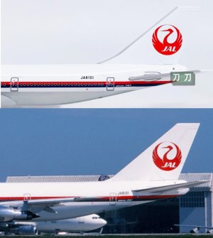

I don't suppose you fancy doing some work on this Alex because I admit I'm not seeing the issues you are. For example:
I think I will keep the Jet X JA8101 (I have modified it with NG gears anyway). The font reg on the HX seems off and of course its incorrect position
Make this three versions and without looking any deeper into it, I think HX mixed two (not the reg pos.)
Grey belly reg posn vs bare metal reg posn ?
There's also the lower fuselage grey composite bit on the bare metal version (unless it's some reflection in the shared photo) - which the pictured HX version doesn't have
Grey belly reg locn vs bare metal reg locn ?
JAL 747s were delivered with all white stabs.
So either doing satcom/all white or no satcom/corogard would be consequent. I'm not saying this didn't exist, but I'd have made it consequent.
Edit: now that I'm looking through some pics, I see you could easily make four variants.
This would be version 5.
8101 - like most others - was delivered in Boeing's standard painting pattern but quite a few operators opted to paint the lower belly grey for better corrosion protection/FOD detection. That said, I wonder if we'll ever see a correctly done 747-130 "as delivered". I've never seen one.😉

What decides about me buying or not is if my OCDed eyes can "tolerate" the looks of a mould. Livery/printing accuracy is only secondary if at all. In case of HX's 747 mould my eyes say "no way!", but a satcom, corogard or reg. position wouldn't kill the deal.
If @YesterAirlines hadn't shared the two images, I frankly wouldn't have realised what @Phantom was referring to. I understand the OCD challenges of someone who designs and makes.
