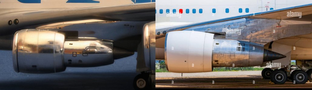

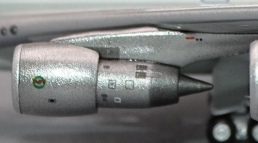

Here's a close up of the inner HX pylon in question (taken from an image shared by Jazajia) compared to the real 747-121 pylon on N747GE. I see at least 4 areas of improvement:
  1. The thickness of the wing
  2. The pylon shape
  3. The engine cowl shape
  4. The inlet ring being a separate piece is adding extra thickness and chunkiness
Happy Collecting!
  2. The pylon shape
Happy Collecting!

For sure HX wont do a new wing. NOT because the wings would snap (come on ?!) when they are realistically thick - they aren't far from it and only have an incorrect airfoil - but because benefits are in absolutely no relation to effort. We all agree, but hey, this is a discussion forum, isn't it?
The pylons could be adjusted to fit the given wing profile by just altering the LE and the contact line to the wing. A retool that only depends on whether HX are content with what they have or not. But a problem for neither engineering nor quality.
Thinking about the engine I'd have half a dozen different approaches in mind of how to design a 400 scale JT9D. HX opted for the more complex approach which sadly doesn't yield the highest accuracy, but follows the recent trend of having more gimmicks. Hollow core with 16 fan blades to "see through"! Too bad the real thing barely allows any see through with its 46 (!) blades. So instead of adding all this complexity and possible QC issues with that inlet ring and see through fan, they could have easily gone the simple appraoch with a solid core fan and a single piece fan cowl. While maybe not achieving a proper count of 46, it would have led to a noticably increased scale accuracy around the inlet, likely less costs and less QC concerns. Ironically, the fan cowl dimension on HX looks fairly good without the inlet ring.
