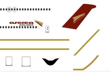

I am working on an artwork for an Aserca DC-9-30:
I can't print white so I'm planning on printing the entire crimson tail with the logo on it on white decal paper and painting the crimson portion on the lower fuselage.
Testors enamel 1104TT looks good to me, but I am trying to find the corresponding HEX code to print the tail decal (See the screenshot attached. The tail is narrower on purpose to match the poorly proportioned Net Models mold...)
Google did not yield any expeditious results on the subject, so I'd figured I ask here.
Thanks in advance for any help!

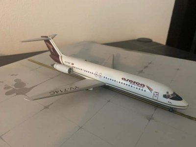

I made this one out of a hasegawa DC-9 I converted to a series -30. I tried to match the color to that same picture and also painted the tail. The logo on the tail was a white decal cut on a cricut. I placed the color decal on top. I would also paint the tail white and place a mask made with the cricut to paint red above it. Once clear coated, place the decal in the area.
I'm so glad you chimed in, I thought about tagging you here. I had seen your Aserca custom before and was wondering how you had done it. It looks amazing by the way. You are very talented.
Cricut, okay, I did not know what that was until 2 minutes ago, I think I might be adding one to the tool repertoire before the end of the week, looks so promising...
Hasegawa, that is 1:200 then, correct? Do you think a Cricut will work to cut out a piece of masking tape matching the Aserca logo in 1:400. I'm also using the Net Models mold, which has a shrunken tail :cautious:

Thanks. So are you, I love those Servivensa customs and Super 27s you made. Mine are still pending. 😁 Actually I want to make the Aeropostal Super 27.
There are several cutting machines. Honestly I've only used the cricut, but after some extensive online research that I decided to get it over the others.
I think it should be able to cut that logo that size. Infact I'll make a quick test today and check.
