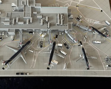

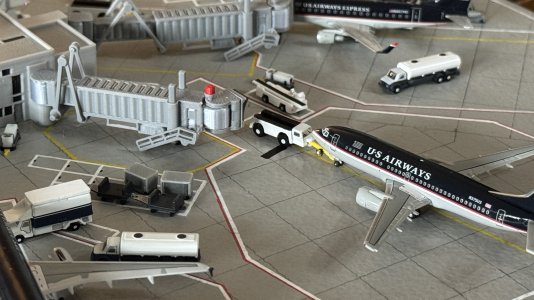

I told myself i’d wait till more was complete but I had to set up a quick diorama to check spacing and make sure everything was still good! These jetways are from my PIT diorama and I think I want to try Clippers new jetways he just released so I may upgrade to brand new ones once this board is more complete. It will be a slight pain as some need to be very specific sizes (example being where that 757 is parked) and most of them will have to be quite short. I’m still working on this board today and hopefully I can get one or two more gates mostly finished by the time the next update comes through. Enjoy!
I like how, in the first pic, we see from the biggest to the smallest, from left to right! 😆

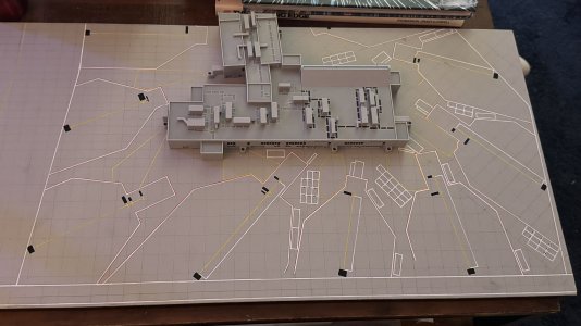

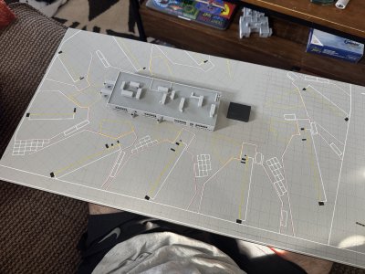

Long time no work getting done…let’s finally change that.

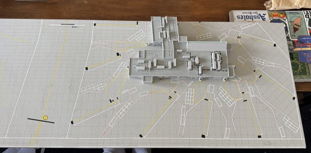

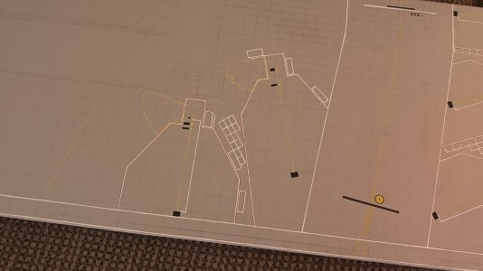

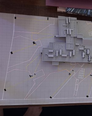

The last few days i’ve been tediously painting the concrete color onto the board, doing concrete lines and getting my spacing correct. I’ve started with laying out the taxiway between both terminals and sketching out the service road that stretches the bottom of all piers in PHL. My white marker ran out so I couldn’t get very far as you can see. While some new ones come in i’ve been able to start the gate centerlines instead. Everything is laid out and this is how most of my dioramas tend to look at this stage. All the important stuff is generally all here now and I can start focusing in on detailing each section at a time.
More updates to come once those pens come in. Should be next Tuesday. Excited to start this back up again!
My question is how do you translate the markings and everything from the sketches to the board so easily?

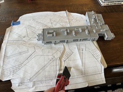

I will show that process tonight for you! I basically use the “sketches” as loose tracers. I exacto knife out around the gate boundaries and start doing my outlines there. then all the smaller markings surrounding all of them. It will make sense when I get some photos when i’m off of work!

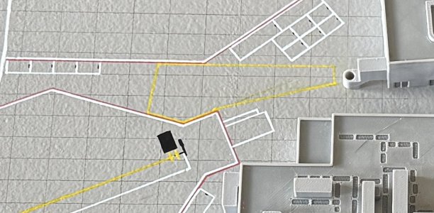

It’s hard until you do it a couple times. Airports have certain regulations depending what aircraft go where of course and there’s some loose literature surrounding certain airports and FAA/global requirements and regulations.
Seattle actually has documents online for their ground markings and what lines go where and how big/long each line is which is fun. For example on PHL here, I haven’t found anything online like Seattle’s but if you look at nearly every other US Airways owned gate from 2005-2015 you’ll see they’re all the same basic shape. Anything up to an A320/21 on this diorama is the “triangle with a box top” as I’ll call it. I’ve made the max width on those to be ~1 7/8in on each side of the centerline, as in scale that’s generally about how wide that space is to accommodate those aircraft. The 757 gates change by adding the flat perpendicular lines in front of the engines, and also increases overall width to ~2in on each side of the centerline. Some airports are even a touch bigger to specifically accommodate winglet 75s easier. The 767 gates are the 757 shape, but bigger now! Every US Airways gate (mostly) has always looked like these which becomes easy to replicate as you do things. Certain gates will also have their own quirks depending on space requirements and all that fun stuff which does make it more difficult.
I am home now and want to work on this anyways so let me do a new gate and try to remember to take photos during the process!

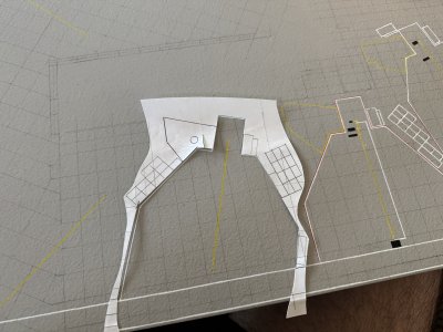

First I take my trace and cut out a certain area, for this board i’m cutting out each gate as I go along like so:
Next I slice where i want to start, in most cases with gate markings, I’ll start with the aircraft safety perimeter:

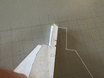

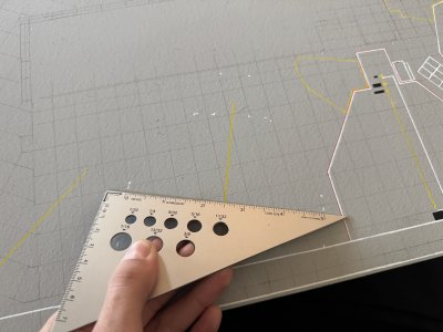

Next, I align onto my centerlines to make sure i’m in the correct spot. If you don’t have center lines yet you can always start with that first by doing what i’m doing in the photo. Y be able to see by folding your paper where each line can go and how long each one should be:
Next I make small hashes around each corner and get my reference dots. It’s all about connecting the dots from here! Details are easy to replicate by feel after this generally. Once you find the sizes for things that look good you can replicate the dimensions at every gate (belt loader boxes, baggage cart boxes, tug and push bar boxes, etc)
“Last” step is getting my final width just to make sure things are all the same. I cross reference with my cutout of the gate and make sure nothing is drastically different for any reason. for example, this gate is another 762 sized gate so it gets 2 1/2in on each side of the center line:

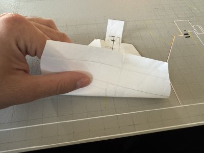

Nose wheel stop lines are easy to get by folding your gate in half and copying what you’ve already done:
Jetway safety zones and GSE markings are easily replicated using the “scrap” from before!
I hope that helps @PeachStateAviation ! that’s my process for gate markings at least. Other stuff is the same but can be cut up differently depending what it is.
