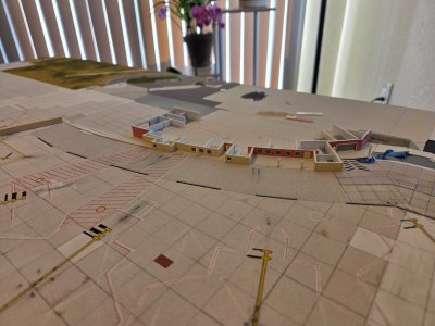

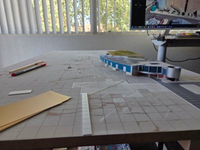

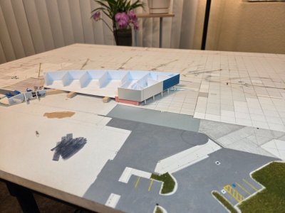

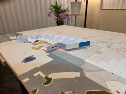

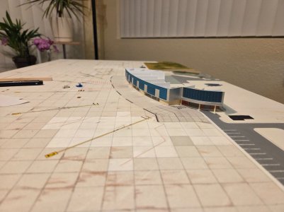

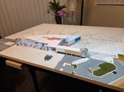

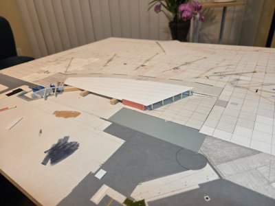

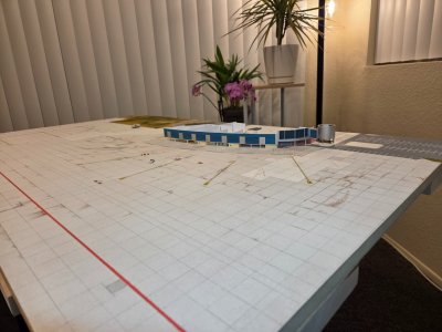

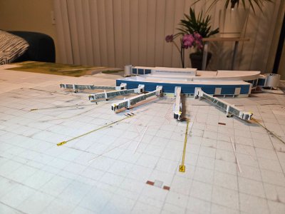

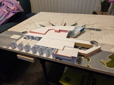

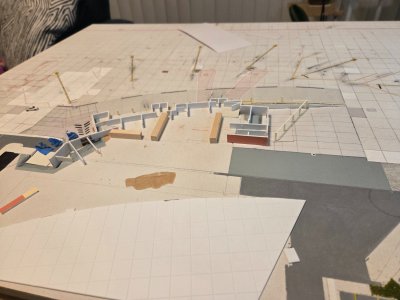

Update for today:
I still have a few tweeks to do to this structure and pylons. Next up are the front windows and second floor to gates. More updates on the way!

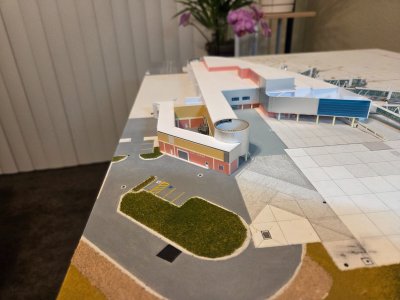

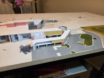

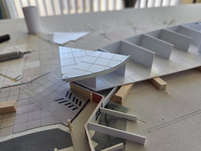

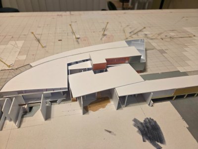

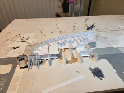

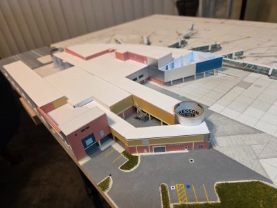

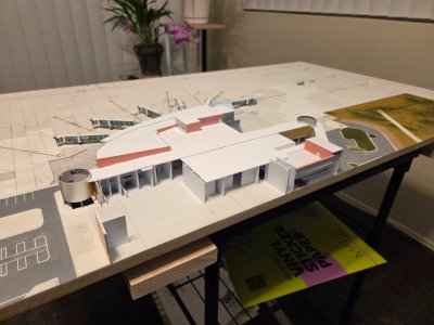

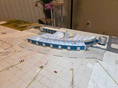

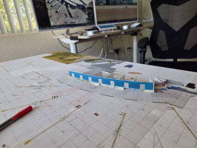

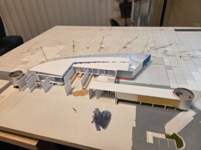

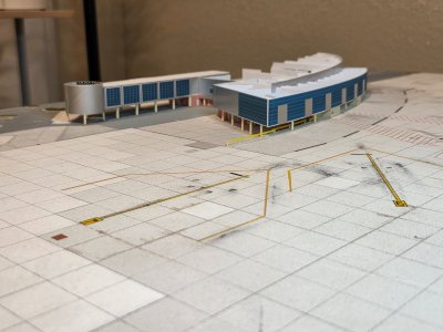

Here's another update:
I'm beginning the curvilinear and sloped roofing as well as the airport operations side (which most likely was part of the old terminal based on the looks of it and location). This has been a real challenge, but fun. I'll keep more coming as I go.

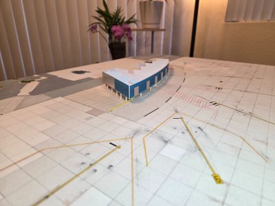

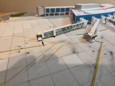

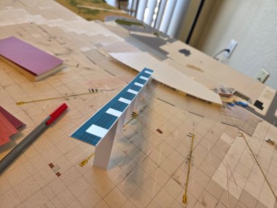

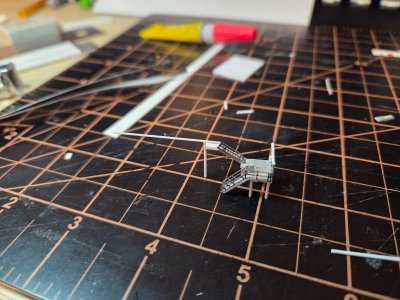

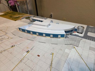

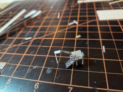

Update from this Tuesday:

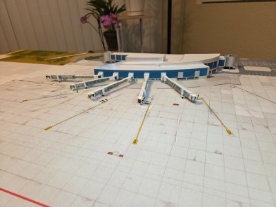

I started the gates a few days ago. These are a real tedious task; one of the hardest I've ever done in '400 scale. The gates mostly consist of JC Wings '400 747 two set -- 3 packs which works for the six gates @ AMA. AMA isn't just a more difficult because of the architectural design, but has gates that would have to be customized to meet the realistic look. Each gate took a while consisting of thirteen(13) different pieces put on from plastics and other 3D prints bough off eBay. The gate connections to the terminal consist of seven(7) different cut and sanded pieces as well. You'll notice the longer glass front of the gates which is the extra pieces from the JC Wings packs that's been cut and sanded. Yes, a lot of sanding from various gradients. I have one more gate (gate 2) to finish up and then need to detail the stairs and tweek some balancing on them. I'll keep you all posted on updates and thanks again for the comments everyone!

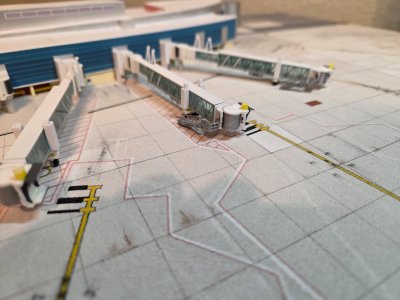

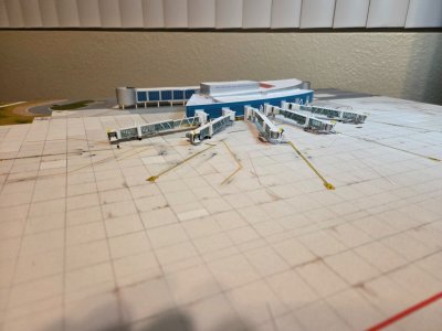

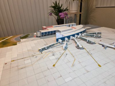

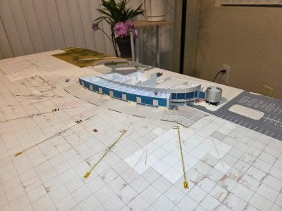

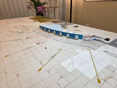

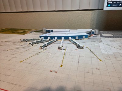

Here's an update on the gates:
The gates are fully adjustable to about a 747 down to a CRJ or below. These have been difficult, but worth the hassle. One more gate to go. More updates to come!

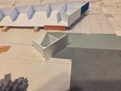

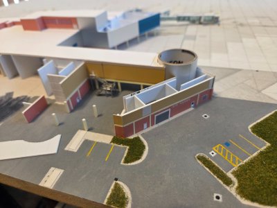

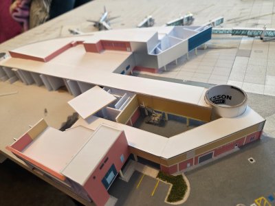

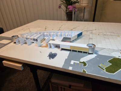

Here's an update from this Monday:
Just about completed the airport operation side and moving back to the ticketing / main portion of the terminal. One this is complete I'll be filling in some added detail and going over any roughly done areas of the terminal walls / roofing, etc. Thanks again everyone! More to come!
