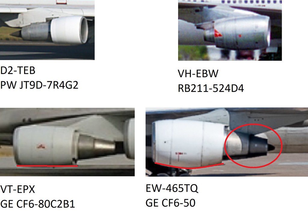

Secondly, the engine options. There are actual 5 different options according to what I have collected, but only 4 different outlooks to be seen. Those are:
- PW JT9D-7R4G2
- RB211-524C2 / 524D4
- GE CF6-50E2 (on the classic 742s)
- GE CF6-80C2B1 (on the modern B744)
The classic CF6-50E2 has a more bulbous side-view, whereas the modern CF6-80 curves very little. The difference is shown in red curve/line.

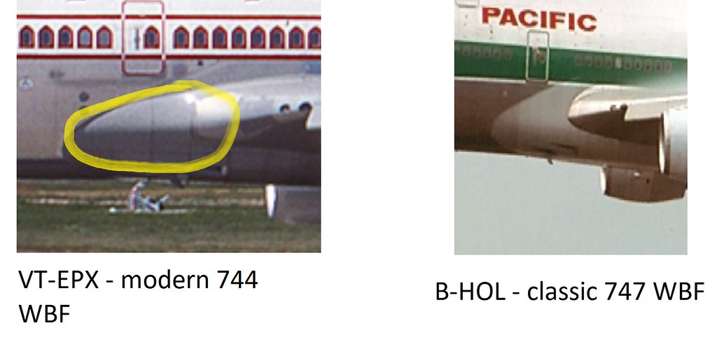

And finally, our main topic of interest: the wing-to-body fairing. There are 2 versions available, which include the original B747 classic and the updated, streamlined, more aerodynamics one found on the successful B744. The difference is marked yellow.

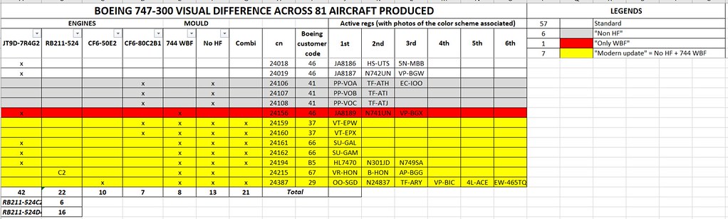

Also, from my research, I have tried to create an Excel file which contains the info above with the 81 airframes. The active regs mean that the aircraft was in used and had a livery with that reg. There are cases that 1 reg has multiple liveries. I really hope that any future B743 manufacturers would come across this list.
I have divided the visual appearances of the B743 into 4 different versions:

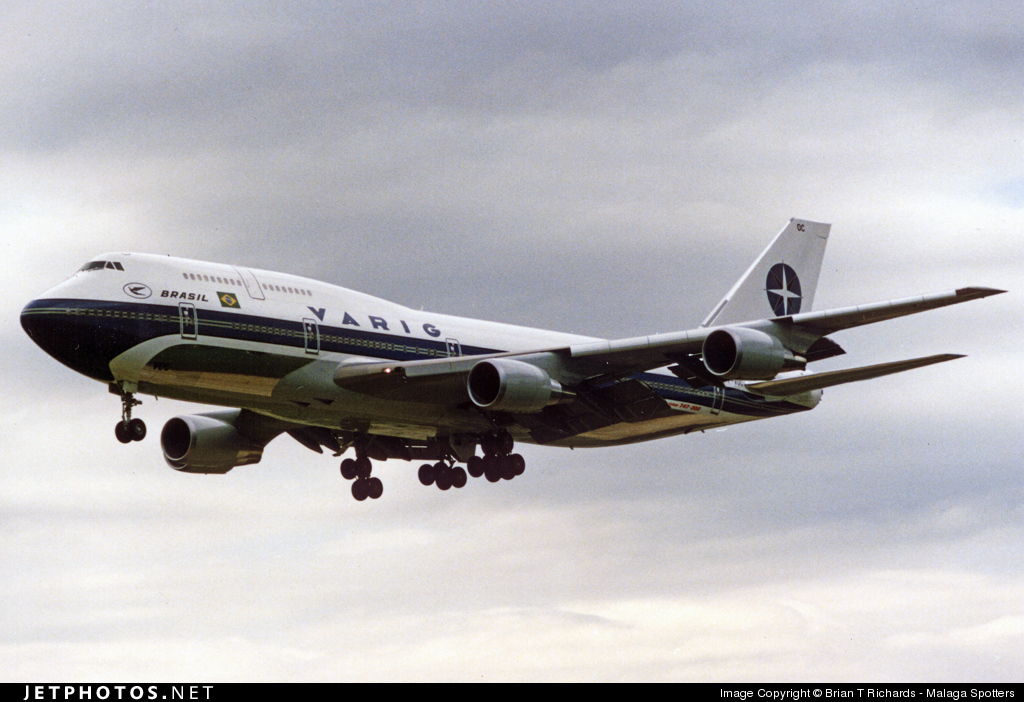

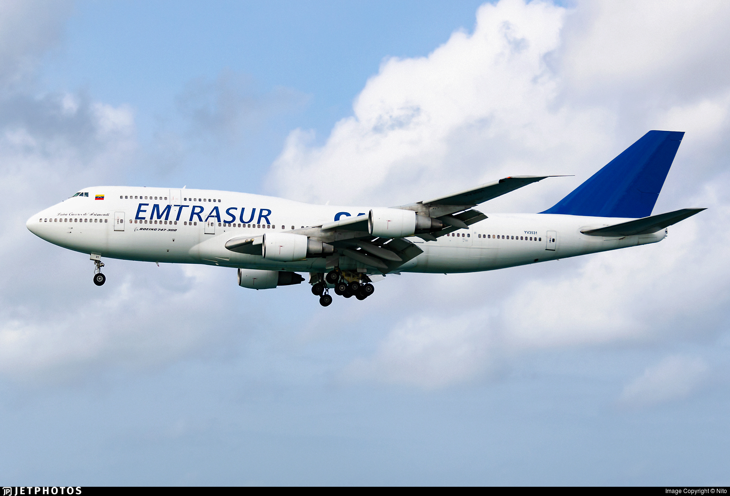

- STANDARDS: with HF wingtip and original WBF. There are total 57 aircraft. An example: cn 23413 YV3531 Emtrasur: GE CF6-50E2, with HF antenna, classic WBF.

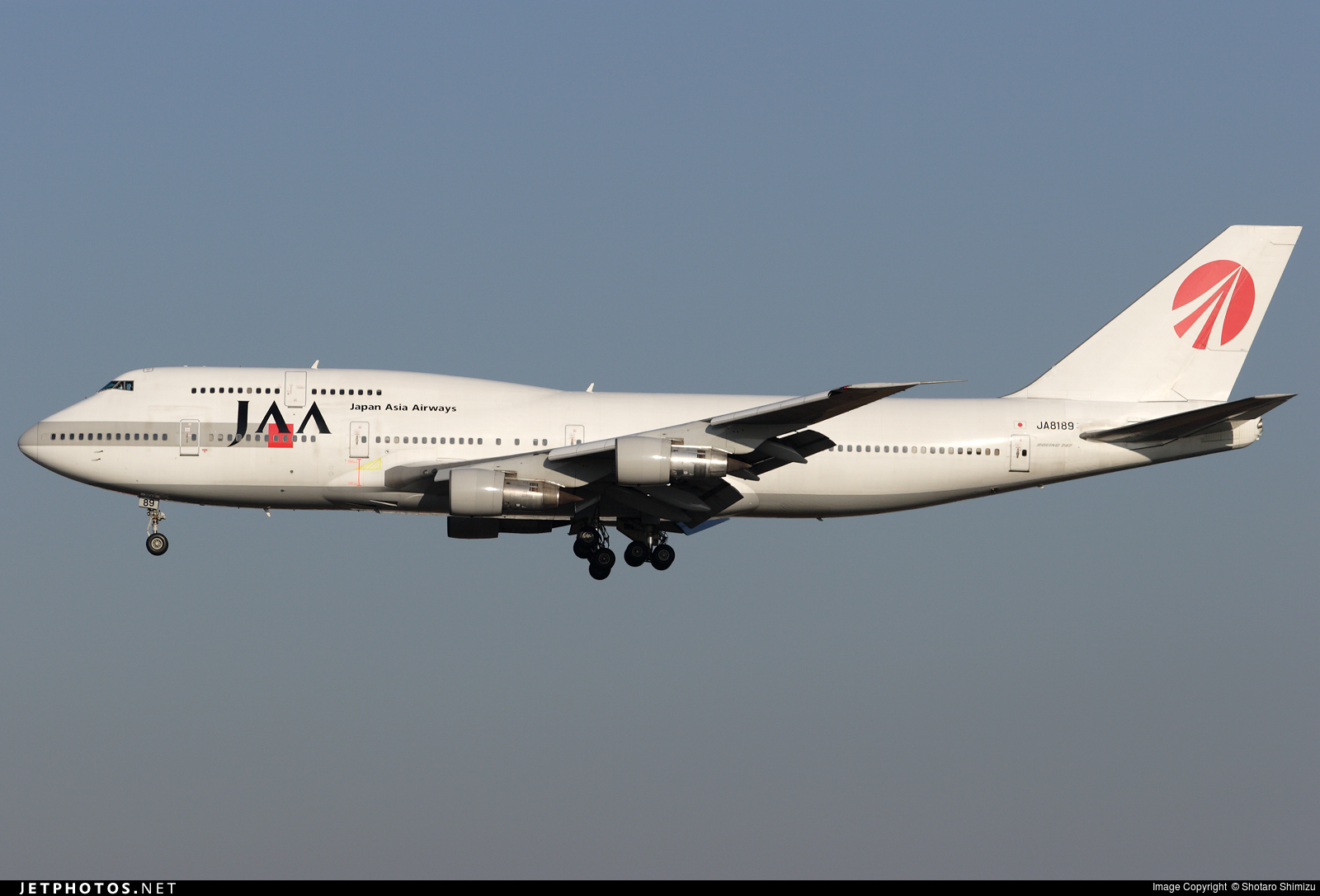

- Non HF has 6 aircraft. Example cn 24108 PP-VOC
- Only WBF has only 1 - cn 24156 JA8189.
- Modern update = 744 WBF without HF antenna on the wings. Total 7 aircraft. Example: cn 24162 SU-GAM

Fuselage: 2 (classic (can be used to make B747-200SUD) and B744 (with the modern WBF))
- PW JT9D-7R4G2
