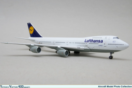

I have nibbled on this topic, mainly on this article: https://www.yankeevictor400.com/post/the-best-and-worst-747-100-200s-in-1-400-scale

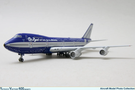

Below is a BigBird Mk3 from circa 2020. Low and oversized cockpit windows, but the narrow (incorrect) forehead hides it and turns it into a wondderful model.
Below is an older original BigBird. Almost the same issues expossed above apply:
I believe Witty at some point realized that BigBird and Aeroclassics had gotten the windshield placement wrong all along and tried to fix it, but the mold simply did not have the propper shape to accomodate it, as we can see on this Witty/Apollo below:

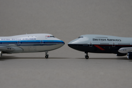

The model below is from before the 2020 period, which might be the reason JC and AC went back to the traditional cockpit placement expossed on the photos above.
Curiously, some of the non-Aeroclassics examples from circa 2020 seem to have started to show the current larger forehead, as the KLM example below shows:
Seems like BigBird Mk3/JC compensated with a larger windshiled, as it is still clearly too low, but it does not frown like current Aeroclassics.

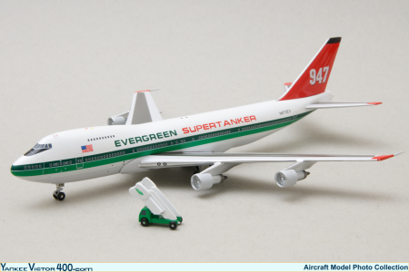

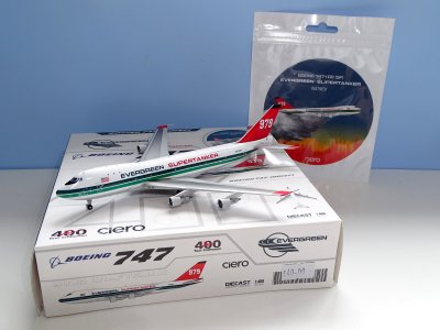

A recent acquisition of mine is this BigBird Evergreen Supertanker 747-100 from last year. It doesn't seem to have sold well so is quite easy to find at discount but has some lovely detail on it, with extra aerials and especially the fire retardant pipes on the underside. The tail fit is a bit odd though and makes the tail titles not level.
I really like those strakes/lines on the top of the wings, near the leading edges. I believe only the B747-100 had them???

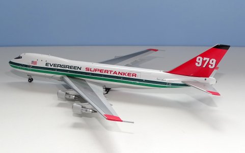

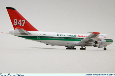

I got its sistership N470EV (947) made by Aeroclassics. I needed the specific reg as it was previously N749WA, which among other things flew freight for Viasa for some years. It was the only 747 to ever wear full Viasa colors.
I went for the erroneous "Supert Anker" version. There was a re-run with corrected titles, but last I checked it was hard to find.

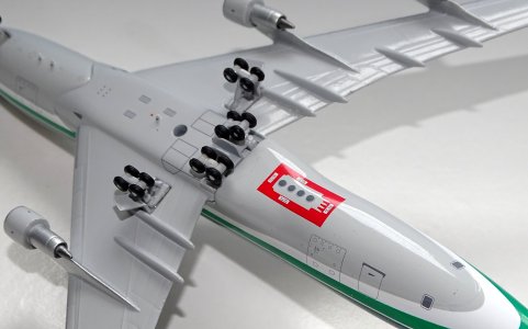

The Aeroclassics one has the fire nozzles printed in too. Does the BigBird Mk.3 actually have some moded-in details there?
Perfectly shows what's possible with this mould. Very nice detailing there.
