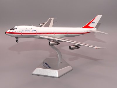

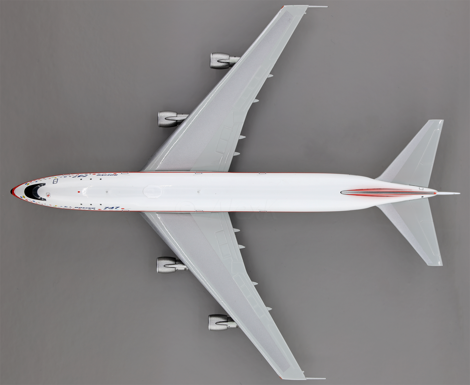

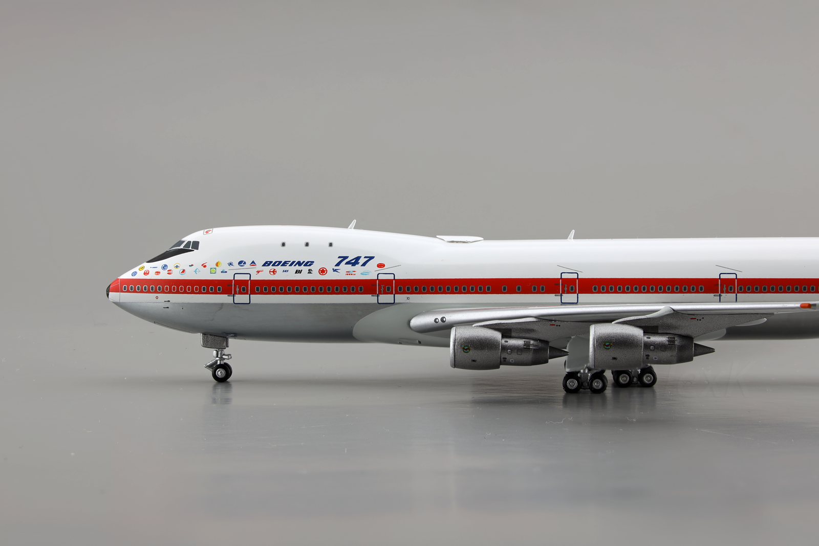

I just received my copy of the HX Models 747-100 and I have to say I am very impressed. While I'd seen a variety of photos of the mould in hand I am surprised by the attention to detail across the model and the overall package. It certainly is what I would consider the first high quality modern 400 scale 747-100 I have seen that I can recommend. Here's my review:
I have seen some of the criticism of the wing thickness and engine nacelles (@Phantom ) and I do not agree that either are issues, plus the mould has a lot of new features and details that make it much much more than a reverse engineered Dragon mould (@keji833 ).

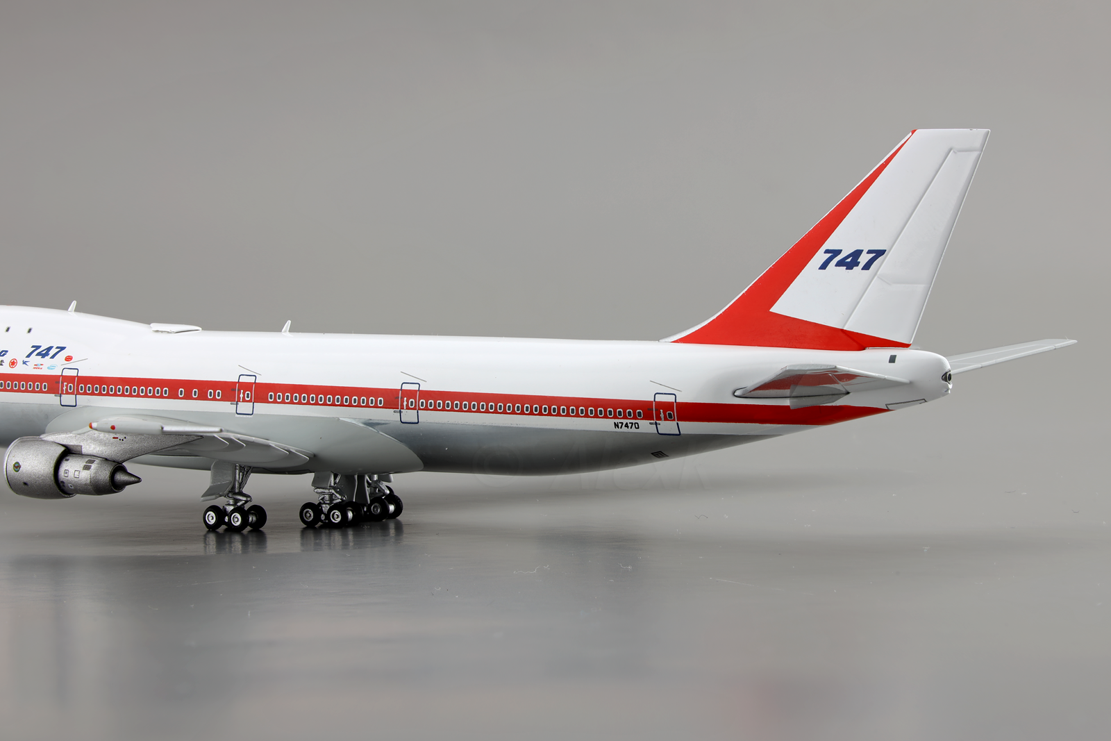

Gear lengths (ground clearances):
A brief look at the measurements (model / Boeing docs) - in mm:
- Fuselage clearance: 7.25 / 4.7-5.2
- engine 2/3: 4.9-5.32 / 2.85-3.43
- engine 1/4: 7.4-7.52 / 4.55-5.33
- wingtip: 18.1-18.6 / 13.4-15.6
Seriousely, this model is sitting on stilts!
Fix this biggest issue and the model looks a lot better.
Enough has been said about engines/pylons - particularly the #2 and 3. There's not much you could do given the wing profile, but I'd set the pylon LE a bit farther front so that it would appear better proportioned.

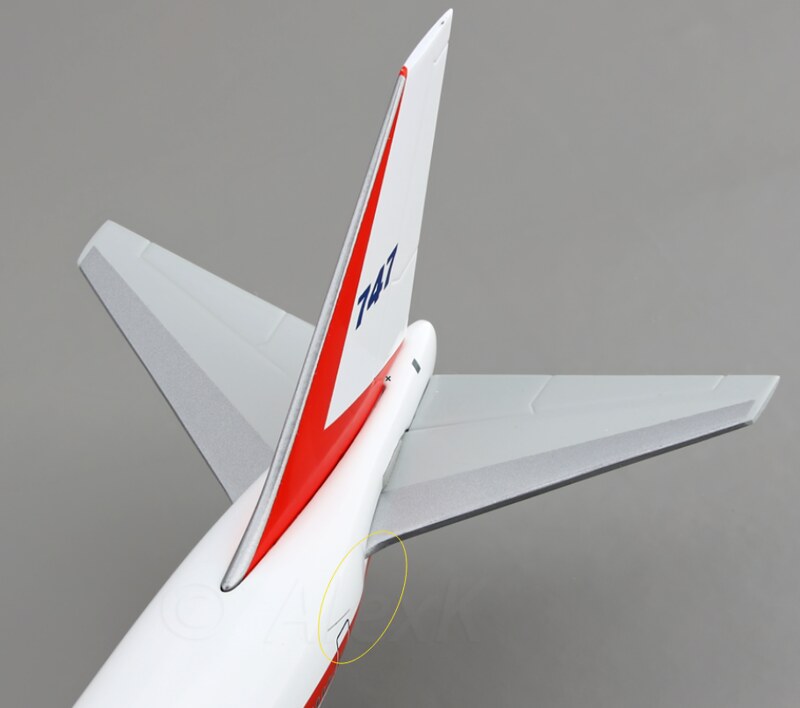

My eyes don't really fancy the v.tail. Without further checking I'd blame it on a too big radius of where the leading edge joins the fuselage. No big deal though.

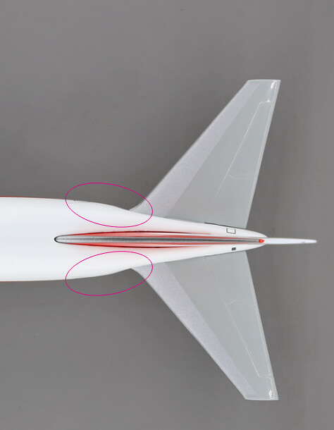

But then there's that issue with the aft fuselage taper when I saw the first production shots (here) - it sure is not as much of a mess than I initially thought but it still looks extremely weird on the model.
I wonder why HX modeled this strange "bump" to the sides of the rear fuselage? The real thing has a rather clean and smooth taper.
HX747ee by Alexander Kern, auf FlickrHX747aa by Alexander Kern, auf Flickr
I've been desperately waiting for a top notch 747Classic mould for years but this one certainly isn't it. While this one's "ok", my wait goes on. But I'd suggest the gear heights to be reviewed by HX to turn this into a "good" mould.

HX looks wonderful to me, but indeed the gear height is bad. Too tall...
