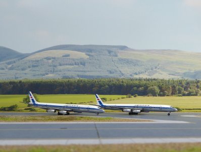

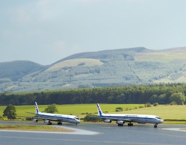

I got this Loftleidir DC-8-63 (on the right side). Unfortunately the fuselage is bent like a banana. Most of the models released (I’ve heard) has this banana shape. But at AACF recently I was given a perfect straight model but missing the front gear. So how on earth can I remove the front gear from the bent one to the straight one?
I’ve tried hot water and hairdryer but the gears are stuck. Impossible to remove.
A typical situation when you want to remove gears they are stuck. If you don’t want to remove gears they normally just fall off.
