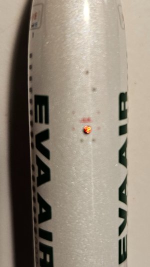

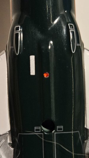

I’ve always kind of thought they were red… all my 1:200’s have the red beacon.image.jpg
